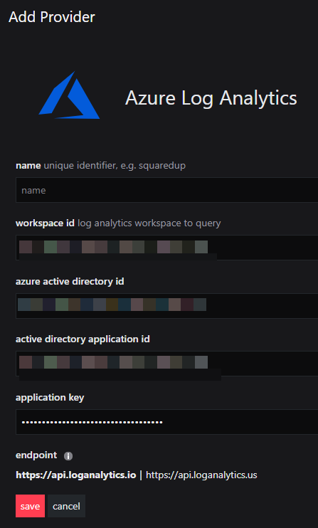

Adding an Azure Log Analytics provider in SquaredUp DS
Now that SquaredUp DS has an identity within Azure Active Directory that it can use to query Log Analytics workspaces, you need to provide the details to SquaredUp DS. A provider defines the Log Analytics workspace that you wish to query, and the identity used for doing so (in this case, the Azure AD Application authenticates to query Log Analytics as the user who authorizes the provider).
If you have multiple workspaces that you want to query, you can either create multiple providers (one per workspace) and/or create an empty Log Analytics workspace for use with the provider, and then use the additional workspaces option in each tile to query up to 10 workspaces simultaneously.
1. Create provider for a Log Analytics workspace
In SquaredUp DS navigate to the right-hand menu ☰ > system > Integrations
- Under Integrations click on Azure Log Analytics and type in a suitable name, e.g.
LondonLogAnalytics.
- In the workspace id box enter the Log Analytics workspace ID you noted down in section D above.
- In the Azure Active Directory ID box enter the Tenant ID that you noted down in section A.
- In the Azure Active Directory Application ID box enter the Azure Active Directory Application ID you noted down at the beginning of section C above.
- In the Application Key box enter the application secret value that you noted down at the end of section C above.
- Select your Log Analytics endpoint. https://api.loganalytics.ioDefault endpointhttps://api.loganalytics.usUS Government endpoint

- Click save.
