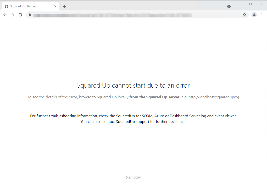

SquaredUp cannot start due to an error
SquaredUp cannot start due to an error.
Startup failed for 'Extension packs'.
