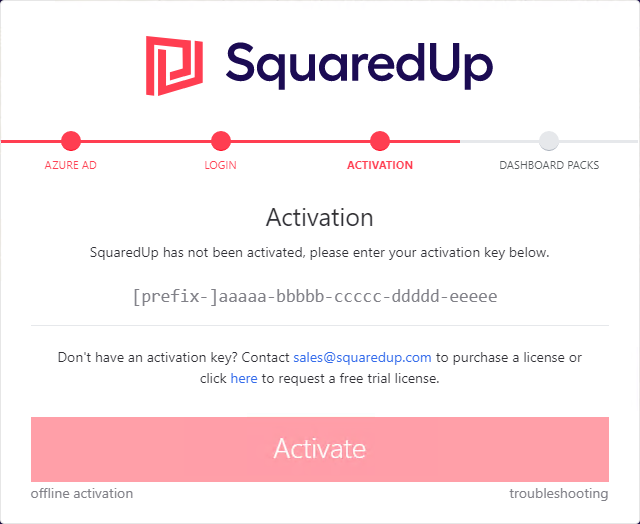

How to Activate SquaredUp DS
After installing, the set up wizard prompts you to log in as a user who is an administrator on the SquaredUp server, then runs you through first-time use: Login, Activation, and Dashboard Packs. See How to install SquaredUp DS for Azure using the installer.
Or you may need to browse tohttp://SquaredUpServer/SquaredUp/Activate
(where SquaredUpServer is the name of the server where SquaredUp DSis installed).If you deployed SquaredUp DS from the Azure Marketplace:
The URL is
https://DNSNameof the virtual machine (VM) deployed.
- Paste your license key into the Activation screen.
Take care to use the correct license key, as many licenses only allow one activation. - Click the Activate button.
- Complete the SquaredUp DS setup wizard.
For more information on the setup wizard stages see How to install SquaredUp DS for Azure using the installer
