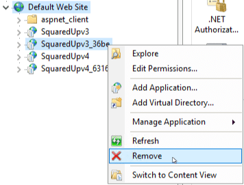

Instances of SquaredUp DS for Azure can be removed by deleting the application and the related application pool from IIS:
- In IIS right-click on the SquaredUp DS for Azure application you wish to remove.
- Click Remove.
- When asked if you are you sure that you want to remove the selected application, click Yes.

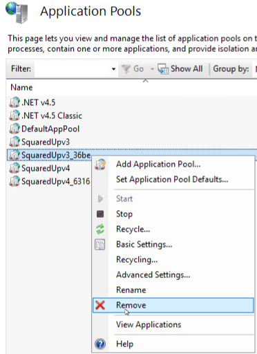

- Under Application Pools right-click on the related application pool you wish to remove.
- Click Remove.
- When asked if you are you sure that you want to remove the selected application pool, click Yes.

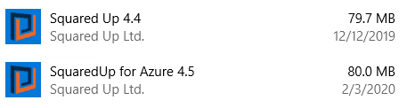

If you upgraded from DS for Azure v4.4 to v4.5 you will see two uninstallers for DS for Azure:
- SquaredUp 4.4
- SquaredUp for Azure 4.5
To remove all instances of DS for Azure you should run the 4.5 uninstaller first, then the 4.4 uninstaller. This will clean up the files from the v4.5 installation and the old v4.4 installation location.
