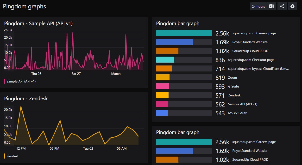

Graph color matching means that one item (a specific resource, object, site, anything you are displaying in your graphs) is shown in the same color in different graphs on one dashboard or one perspective.
Line Graphs, Sparklines, Bar Graphs and Reports (available in Performance tiles) support graph color matching.
Color matching only works when the item uses the exact same label in all graphs.

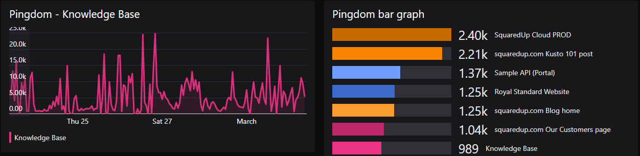

- The label for the item must be the same in all graphs that you want to display the same color.
- In the label panel of your graph, set the label to custom label.
- If you are using a mustache property, make sure that you use the same property in all graphs you want to color match.
If you are using a manipulated mustache label (for example, custom text between labels likeName: {{properties.name}}), make sure to use the exact same label in all graphs you want to color match.
If you are using custom text, make sure to use the exact same custom text including upper and lower cases. - For resources that show the same label the colors will now match:

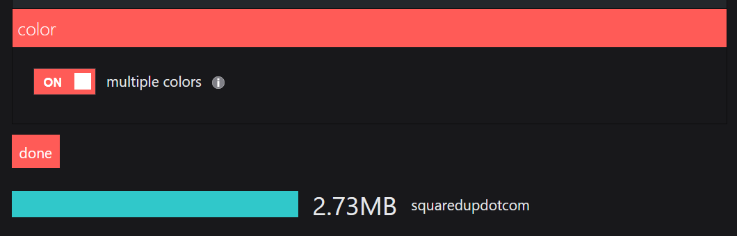

- For Sparklines and Bar Graphs (called Bar Top N in Performance tiles), you need to switch on multiple colors to enable color matching. Multiple colors is switched off by default, you need to switch it on for each Sparkline and Bar Graph.
- Go to the color panel of the Sparkline or Bar Graph.
- Toggle multiple colors to on.
The Sparkline or Bar Graph will now color match, as long as the dashboard setting match by label is on and the labels do match.

How to enable color matching for bar graphs
For Bar Graphs multiple colors is switched off by default, and can be switched on in the color section.
