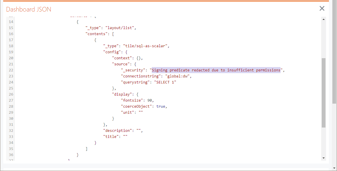

When a SquaredUp DS user creates or edits a sensitive tile, the tile is permanently marked as untrusted. The tile no longer functions until a SquaredUp DS admin restores the signing of the tile. Before restoring the signing, users can't see the result of queries and scripts in the tile, even if an administrator further modifies it and publishes it. This is to prevent the accidental execution of untrusted queries.
To restore the dashboard to working order for all users, an administrator can modify the JSON of the dashboard to re-enter signing into the _security field of the relevant tile(s) and publish the result:
- Enter edit mode of the dashboard with the affected tile.
- Edit the tile's JSON.
 Find the_securityproperty with the valueSigning predicate redacted due to insufficient permissions.

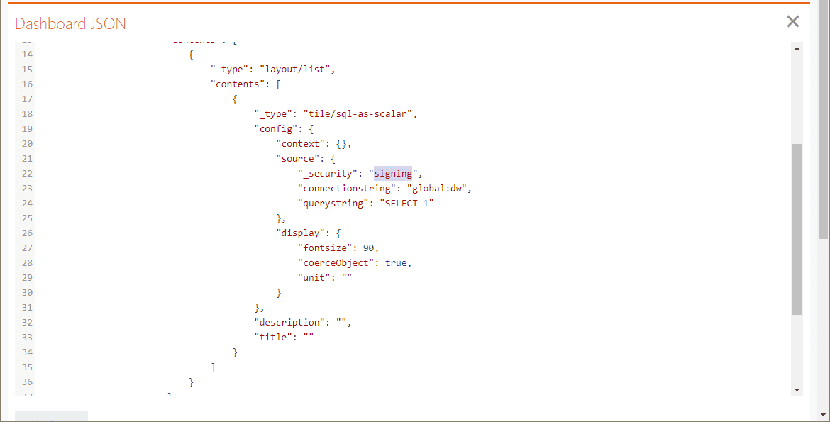

- Modify the _securityproperty to have a value ofsigning.
- Click the Apply changes button.
- Save the JSON.
- Publish the dashboard.
 The query can now execute and the results are available to dashboard viewers.

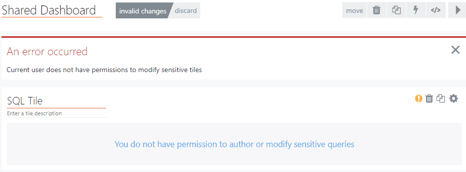

In version 4.5 and above:
Any changes by a SquaredUp DS user to sensitive queries or scripts are not saved. Users will see one or more of the following errors:
- An error occurred. Current user does not have permissions to modify sensitive tiles
- You do not have permission to author or modify sensitive queries
- You do not have sufficient permissions to access this resource
After making disallowed edits to a sensitive query any change (to the query or the rest of the dashboard) cannot be saved. Any further changes to the rest of the dashboard made after the disallowed edits to the sensitive query will also be lost. The user has to click the invalid changes button and then discard to discard the disallowed changes.

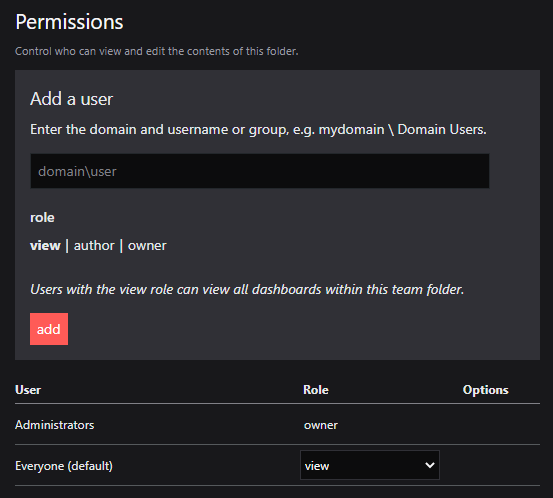

- Make sure the user has the Team Folder role Author or Owner for the dashboards you want them to be able to edit. - In SquaredUp DS, navigate to the Team Folder you want to edit.
- Click on the view folder settings button at the top right of the page.
- Click on the edit this folder button.
- To set the permissions for this Team Folder, add a new user and give them a role or edit the role of an existing user.
- Click save changes.

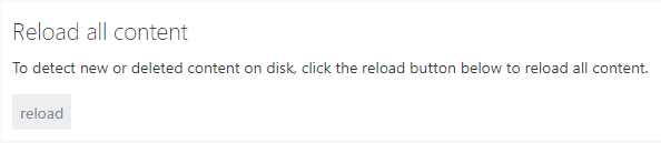

- To see the change take effect in SquaredUp DS either recycle the IIS application pool, or select reload from ☰ > system > Dashboards > Reload all content.

- Only for version 4.4 and below: Giving a user permission to sign tiles does not affect dashboards that have already been authored by that user. If a user already authored sensitive tiles and caused them to be untrusted, the signing of those tiles must be restored. This can be done by either deleting and re-creating individual tiles or the entire dashboards, or by restoring the signing in the JSON of the affected tiles. - To restore the dashboard to working order for all users, an administrator can modify the JSON of the dashboard to re-enter - signinginto the- _securityfield of the relevant tile(s) and publish the result:- Enter edit mode of the dashboard with the affected tile.
